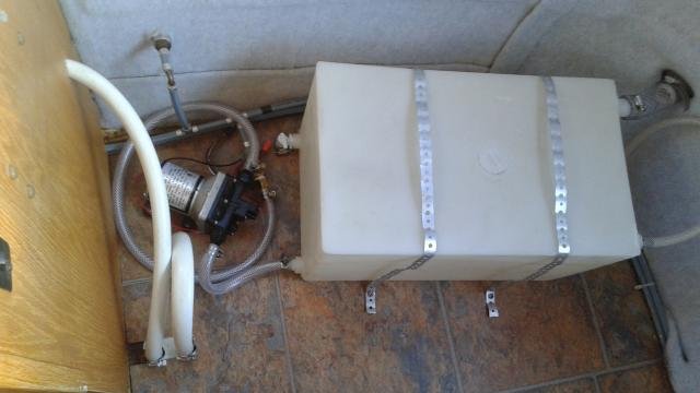

When I first got it, there was no working onboard water system. City water was working, but under the pass bench was a loose freshwater tank, a burned out shurflo pump and nothing was hooked up. I finished the plumbing today of the new onboard water system and it is ready for wet testing now.
New Shurflo Revolution pump, all new braided 3/8 and 1/2 inch plumbing, new tank hold down straps, new filler port and hose.

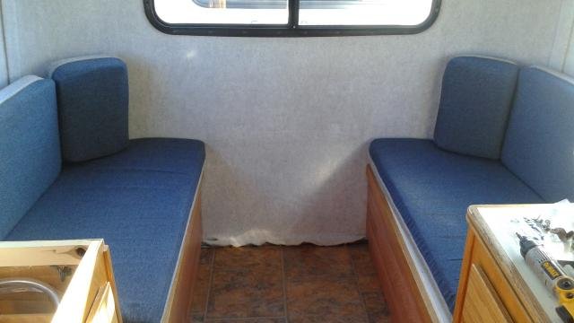

I was able to install both the passenger and drivers side dinette rebuilt benches and cushions.

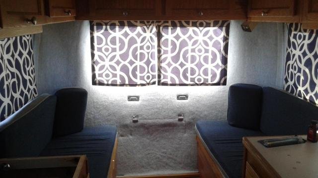

Curtains are almost done and going in
We use blackout curtain panels and a glue gun to make our new Scamp curtains. Been using the glue gun on curtains now for a decade and they hold up as well as sewing curtains but much simpler to do.

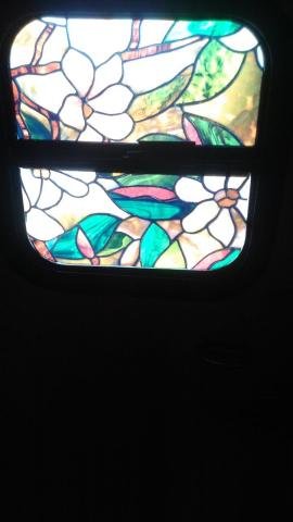

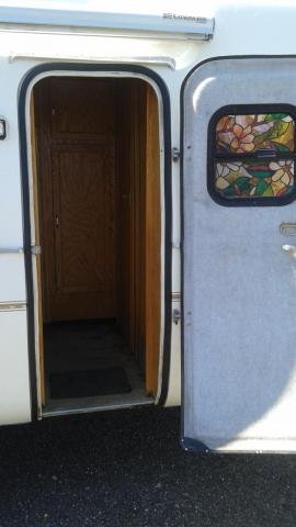

Our Signature Stained Glass Entry Door
This is our second trailer with the Stained Glass Entry Door. We had some left over from the first one, so now there are two molded fiberglass travel trailers running around with this pattern. Note the privacy when the door is closed, eliminates the need for a door window curtain.
