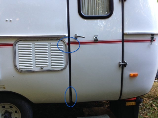

Yeah, it's me again with a whole new issue, but since it may be related to the cabinet rivets issue, I'm tacking it on. Yes, gordon2, I did this for you smiley.
Tonight noticed that the striping was not lined up at the door opening. This is the location where the closet with the refrigerator is located. I checked a photo I took in December 2014 right after I purchased the trailer and the stripe was lined up. Would the problem with the cabinet rivets breaking have anything to do with the door getting out of align vertically? The door still closes without problem, but I noticed the catch has new, deeper cracks in the fiberglass under the aluminum band. The bottom of the door seems to be tweeking to the rirht.  Again I’m concerned to travel with this trailer. I can image it falling apart while I’m driving down the road - but then I have a good imagination.

As Joy said in post 12 the closet is an integral part of the roof support system. This is why one has to be careful with being over aggressive on closet redesigns. I'm not very familiar with the Scamp 16, but the 13 also has a 3/4 " aluminum tube on the interior left side of the door which helps keep the door aligned. I believe somewhere you indicated that the big fridge was not a factory install but an owner mod?? If so, the door mis-alignment starting is probably related to the whole closet/fridge issue. As Gordon says, this is definitely a concern and it needs to get nipped in the bud so to speak.

Check frame
The frame is cut out for the door walkway and metal supports are welded under the opening to tie the frame together and support your walkway. Check the welds under the trailer just below the door. Once under there you will see what I am talking about. You might put a straight edge on the support pieces to see if they are bent under the walkway. Also check to see if the shell glass is still attached to the rear frame walkway rail. I have never seen a  body sag and the door stripe stay above the rear body stripe. Do you have a before picture to post?
