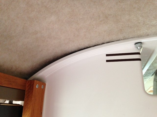

I’ve been full-time in my Scamp since May 4 and about two weeks ago noticed that a cabinet is pulling away from the trailer frame. I have a 2013 16' layout 4. The cabinet in qustion is the one with the refrigerator, which is to the left of the door as you enter.  I sent an email with photos to Scamp and got the reply, "Cabinet probably just needs to be re-fastened in place. Rivet probably broke on top."
Of course, I am really concerned about whether or not this is a major structural issue or just something I need to get fixed? I’m not having much success at getting a local RV repair shop/person due to the fact that all are over booked at this time of year. Would appreciate any input about what I need to do. Has anyone else experienced this issue and, if so, what was the solution / resolution.

On to the cabinet. First of all, from what I can see I wouldn't be worried that this is critical. You want to repair it soon, but there are a lot of rivets in that support piece and just one or two failing won't cause a long term issue unless it is ignored.
It would appear to be a rivet issue, but difficult to tell from the pic. Could you post a pic of the outside at that location that shows the rivets/snap caps going around that support structure. If it is a rivet issue, it's too easy a fix if you have any tools or can get the tools from a Home Depot or ACE. A skill you definitely should learn and repair kit you should have with you if you are going full-time in the Scamp. Rivets can pop or loosen and it's good to be able to fix them quickly and inexpensively wherever you are.
