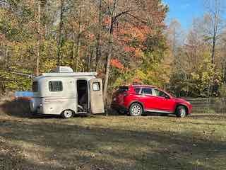

Test for adding pictures
Hello Mr T,
I'm not sure why your pictures aren't showing, but I'm very interested in seeing them.  I'm doing a test post here with a shot of my new-to-me 2014 Scamp.
OK it worked, but it took some work - had to save it in <3 MB, then it took a while for it to load after I hit 'insert'.  Not sure if that helps...
