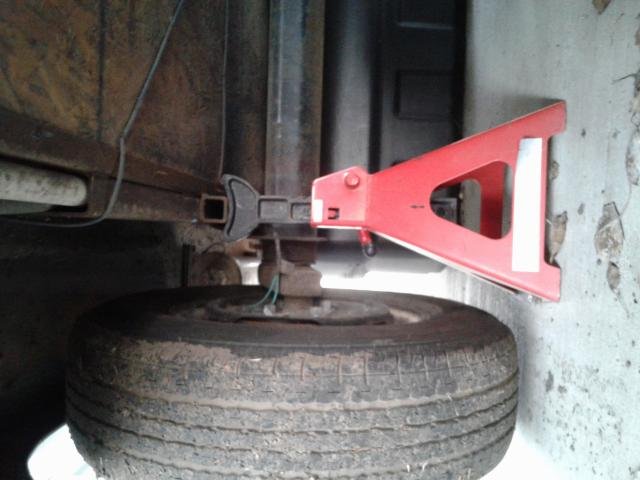

Hi All, I'd like to take the weight off the axle of my 16' Scamp during winter storage but am not sure exactly where to place the jack stands. Does anyone have a photo they could share that shows jack stand placement? Thanks for the help!

This is where I place the Jackstand behind the wheel for winter storage. I jack it up using the same frame piece in front of the wheel. I hope this helps.
Wayne

Thanks Wayne - the photo is very helpful!

Your photo is perfectly positioned, and so helpful in answering this! My thanks, too!
