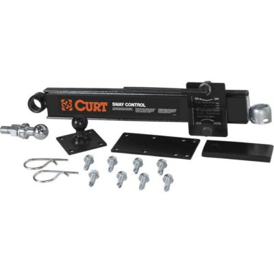

I am towing a 16" Scamp with a Kia Soul.  It also only has a 1 1/4" reciever hitch.  I had to make a receiver fitting to get the height correct.  I did have sway problems and purchased a Curt friction type sway control. This took care of it completely. I was able to travel at 55 mph previously but needed to be quite careful not to start swaying issues.  After the install of the sway control I can travel 70 or more (with a tail wind) with no sway problems.  I had to modify the receiver fitting to allow me to use the sway control.  The kit looks like this and can be purchased from many vendors including JC Whitney.

A version of Husky manufactures such a hitch and we have it on our Scamp now. It has made a dramatic difference, and it was not at all expensive. Did require a mechanic to weld a ball on our removable hitch. Love the anti sway bar and will now never tow without it. Easy to remove too, when backing into a spot or turning backwards at a hard angle.
