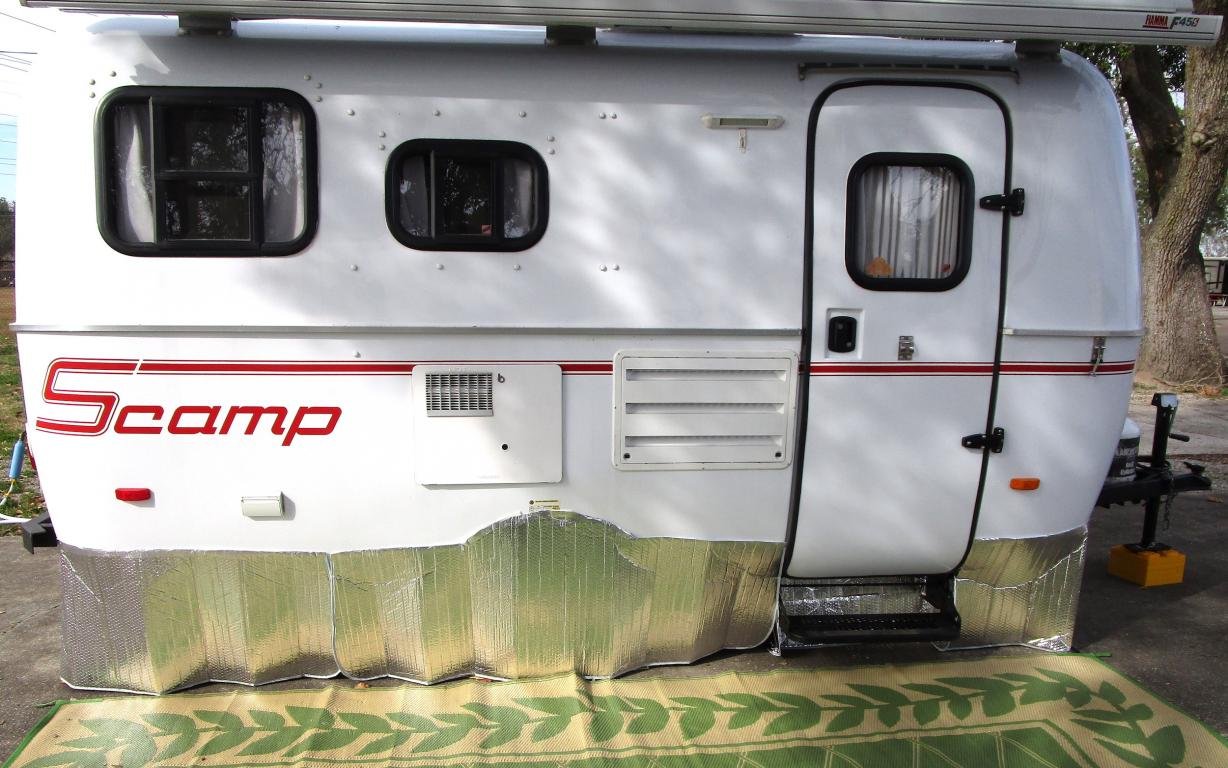

I didn't find this topic in the index. I had an idea to use Automobile Heavy Duty Sun Shades (trimmed to fit) and 3M Command Heavy Duty Picture Hanging Strips.  This probably doesn't require a lot of explanation, but I'll post photos of what I did and how I did it.
So that's what the finished result looks like.  I tried using those foam boards in the past, but I wanted something I could easily fold up and take with me, and those foam board (bales of straw, etc.) just didn't fit the bill for me, I didn't have the storage space for them.  Below are the component pieces I used:

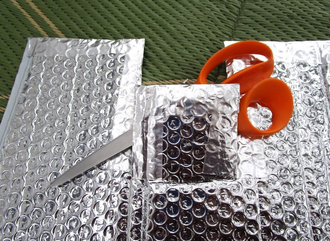

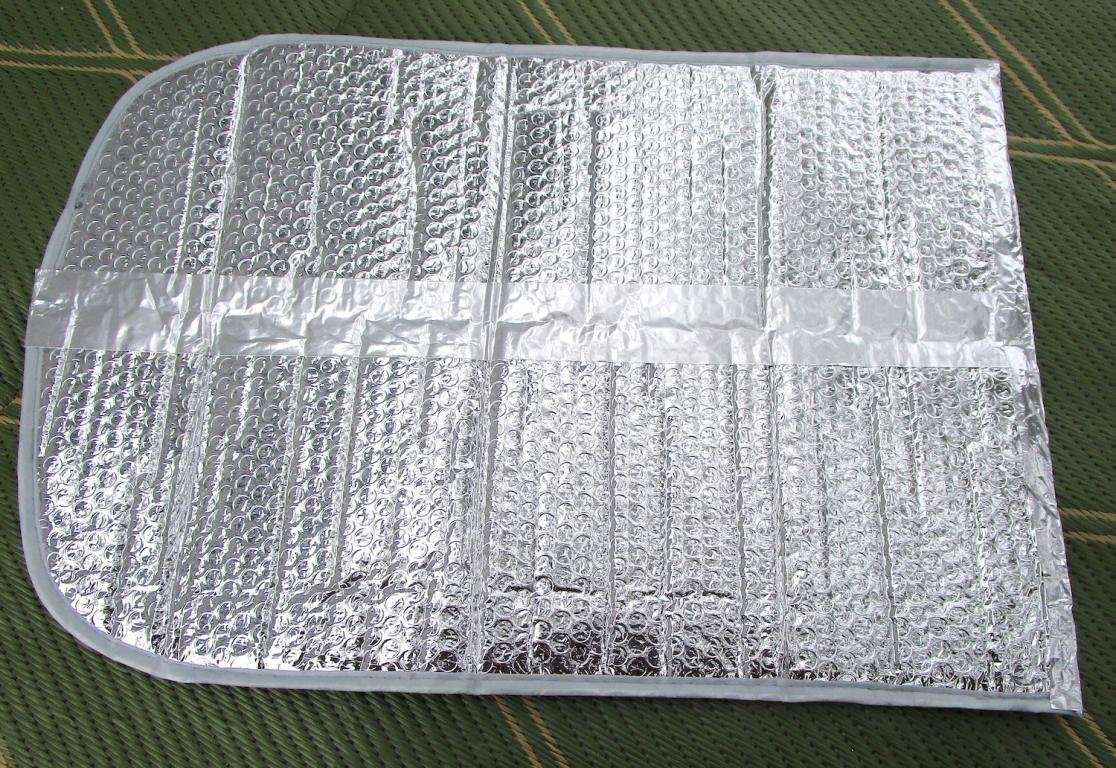

2. Trim the Auto Sun Shade to the height you want.  I measured about an inch above the black border (to allow for the 3M Command Strips) to the ground.  Of course, shape the Auto Sun Shade for the tires, and cut outs for any support brackets.  Then use metal tape to put a protective border on the cut sides of the Sun Shade. Those pictures below:
3. I only installed one Auto Sun Shade and their 3M Command Hanging Picture Strips at a time, since each had to be custom fit. Apply the 3M Command Hanging Picture Strips at regular intervals to the Scamp, just above the black border. Leave the backing on the 3M Command strip that will be facing the skirting at this time. I spaced the (large) strips probably 10" apart.  I did try the medium Hanging Picture Strips, but they weren't as secure, but were good in tight spots.  Once you have them placed, fit the Auto Sun Shade (new skirting) in place.  Now removed the backing from a few strips at a time, so you can make adjustment before fully committing the skirting to the adhesive strips.  Pictures below:

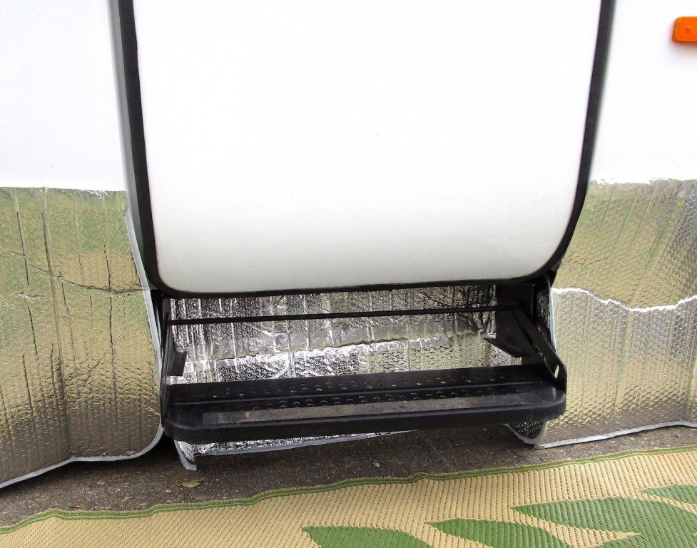

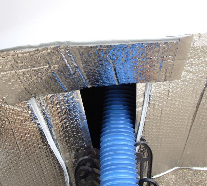

4. Left over Auto Sun Shade can be used to fill in the gaps, such as under the step, around the sewer lines.  I taped some pieces together to make them bigger. Pics below:
I used 7 of the Automobile Sun Shades to fully skirt my 16' Scamp.
