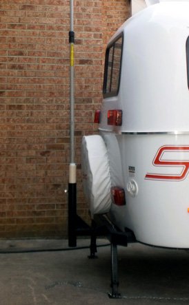

I am thinking of bringing along my Yeasu FT 897 (with the LDG AT-897 plus tuner) in our 13 footer.  I have a Buddipole antenna that has been unused for a few years.  Are there any verticle antennas you all favor?  Screwdriver antennas?
I am interested to know what antenna you are using and how it is mounted to your Scamp?  (Bumper?... 2 inch receiver?)

Used a HamStick 20 M dipole
Used a HamStick 20 M dipole on two end to end fiberglass masts (tree trimming castoffs) that were mounted in a flag holder in the Scamp's optional rear hitch receiver.  It got the dipole to about 25 feet.  It works fine but is of course a single bander. The fiberglass "mast" could also support  a sloper, inverted V, etc.
Screwdriver seems rather inefficient if you have room for a larger antenna at a campsite.  Screwdriver seems to be more for mobile operation, esp when you want to tune on the move.
