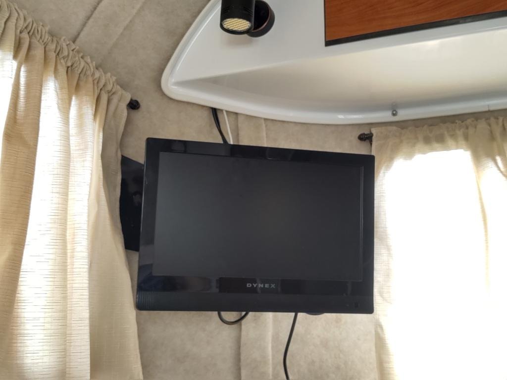

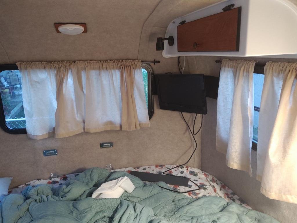

Hello, making  a thread I will update with new mods as I finish them for not only keeping track myself, but also in case anyone wants to use my (stupid) ideas. cheeky My scamp is brand new a couple months ago '19 13fter so my mods for now will mostly be non damaging. First thing I did:

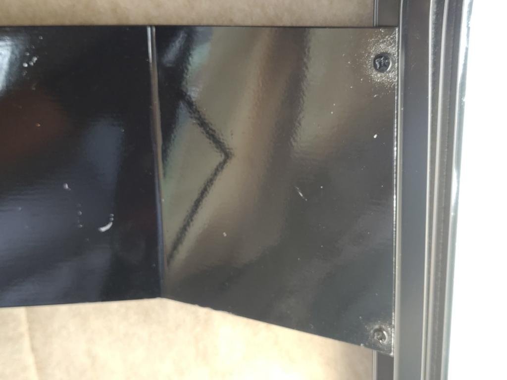

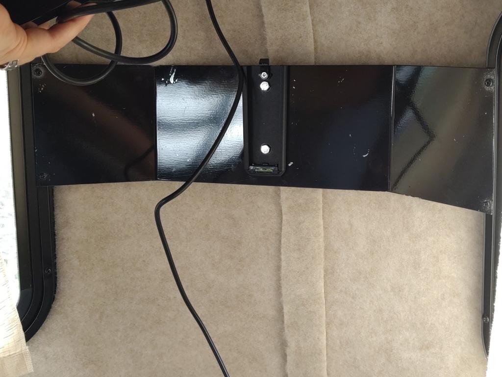

tv mount bracket made of steel sheet bent in two places at about 30 degrees each.
As you can see I used 4 of the existing screws for the window frame (2 on each side). I made the bracket but then bolted a low profile tilt mount from amazon to it. Need to touch up the paint a bit. Next up is a wooden stove cover.

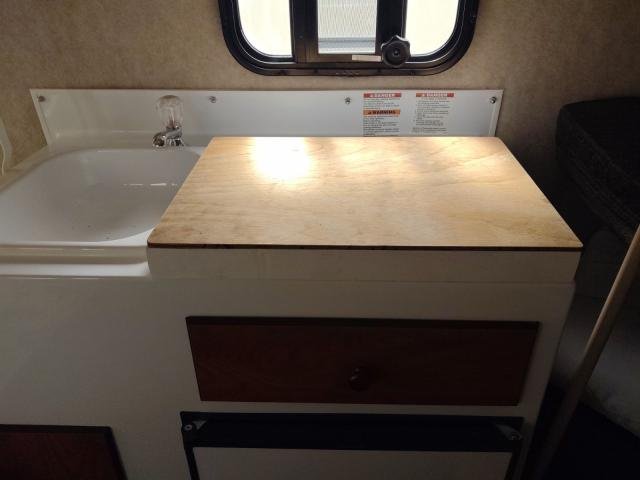

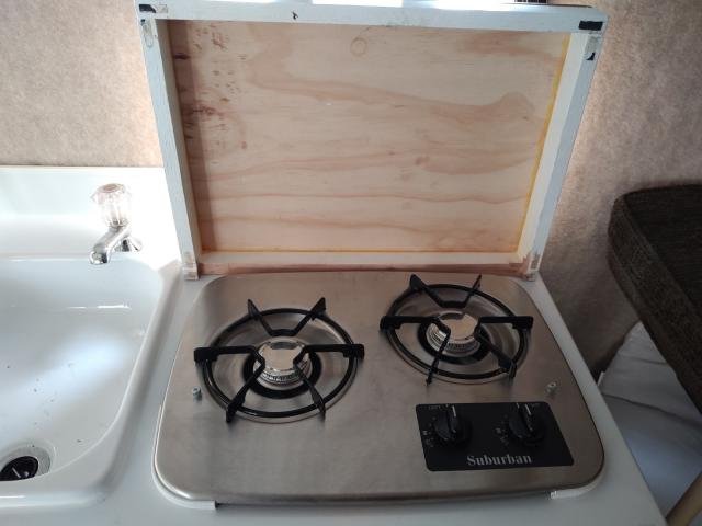

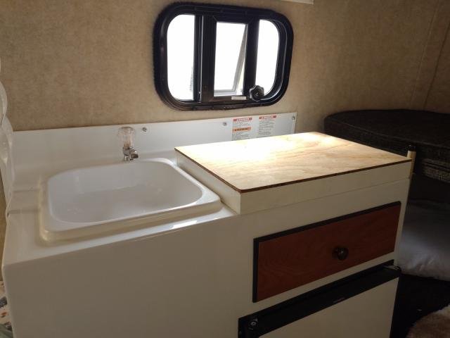

stove cover is done. 1/4"
stove cover is done. 1/4" maple plywood on top of a maple board frame. I actually messed upnthe depth and had to router out the bottom a bit. Don't care what the bottom looks like though.

The first picture it is attached to the windows on each side. 2 screws on each side. I just drilled 1/8" holes in my bracket and then used the existing screws that were already in the window frame as they were plenty long and my bracket is pretty thin.

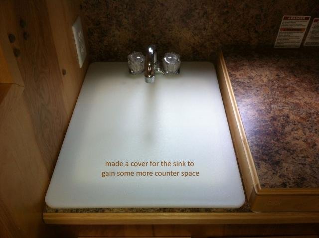

My porch light switch was part of the light, I changed to LED and moved the switch inside between the door and the screen.
I made my own sink cover to gain some space.

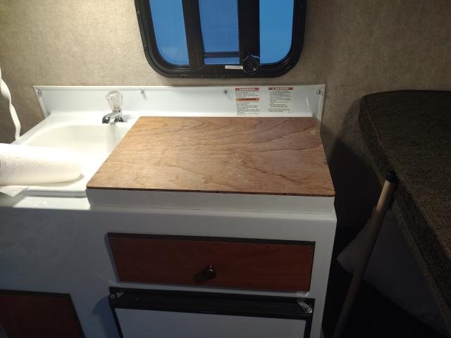

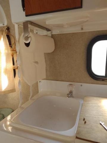

Here is the paper towel
Here is the paper towel holder I went with: https://amzn.to/2SImN4w
I think I am going to take it down and spray paint it white though. lacquer thinner,etching primer, white paint.
