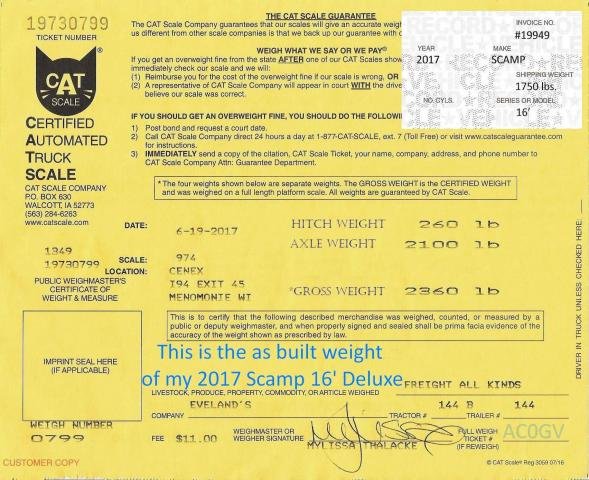

Under the side dinette?
When it comes to towing there are usually lots of replies. Start out by getting an honest weight of the Scamp. Then I like about 10 – 12 % of the total on the hitch. Mine is a little light but still tows nice. If you keep the box ahead of the axle you should be OK. I started with mine under the rear dinette and the hitch got too light. I now keep it under the side dinette, and all is well. With the crown of the road, I like to keep heavy things on the left anyway. (It was abt 600 lbs over the stated shipping weight,)

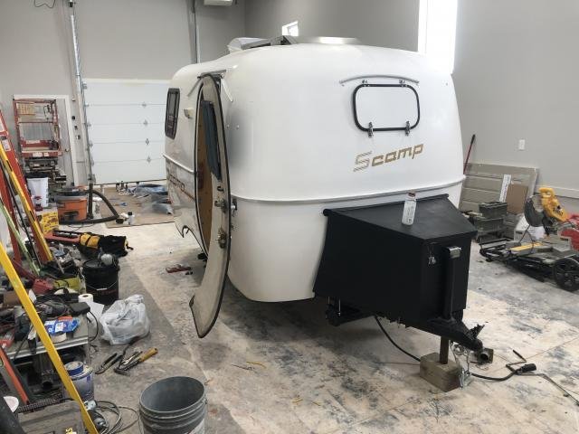

Tongue Storage Box
I have a custom front storage box on my 13' that's worked great. The tongue is a little heavier because of it but it hasn't been an issue for my vehicle. I think it's better and more convenient than having to keep all of the utility stuff somewhere inside where I already don't have much space.
