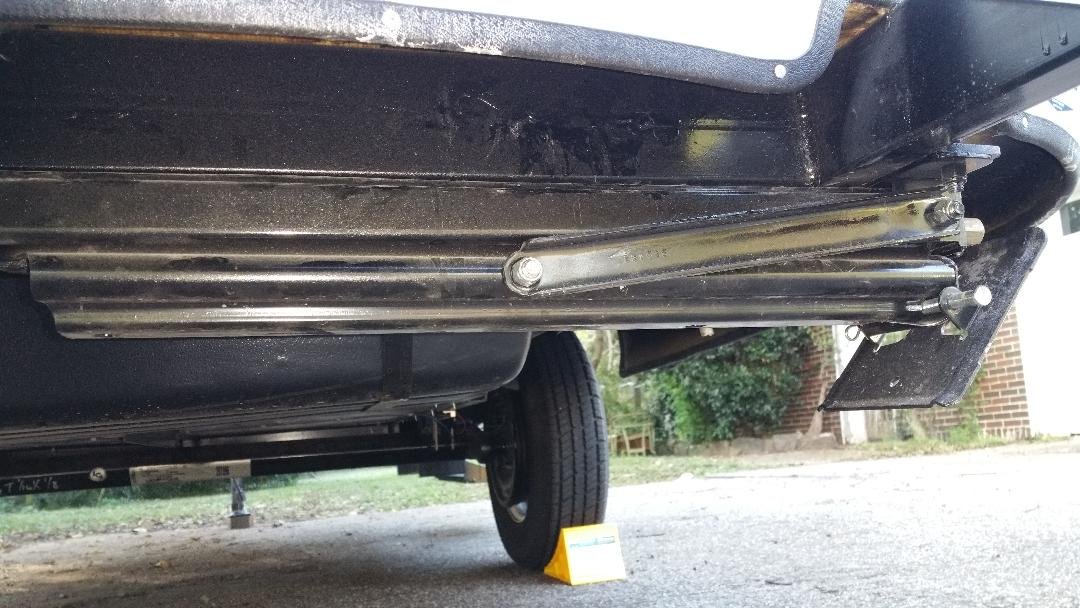

So my new 16' Scamp was delivered today, YAY!  However, I think something is missing from my stabilizer jacks......I've watched the "owners video" over and over and I don't seem to have the special "lever" to lower my jacks, or either I am really a dummy.  This picture I took isn't the same as the one picture in the printed manual.....thanks in advance for your help!!

..... old video They no longer use the type of jacks in the video because no one could run them. They were too easy!
Did they give you a wrench to turn the nut with?? If not, call them.

Those are good jacks too. As already mentioned the nut shown turns to lower and raise the legs. I got tired of spinning mine by hand and picked up a adapter and socket for my cordless drill and the legs are down and up in a jiffy. Just do the final bit by hand as you want to not over do how tight up or down. and keep the screws lubed and clean. I tried some of the dry lube teflon products to keep sand and road grit from sticking on the screw causing them to bind and seize.
