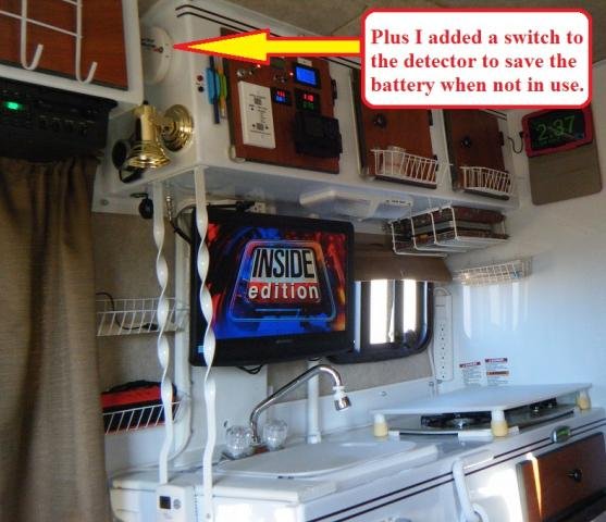

Scott, Do you have more pictures like this that show how you are organizing your Scamp -- the cutting board, baskets attached to doors, wall, etc.?
