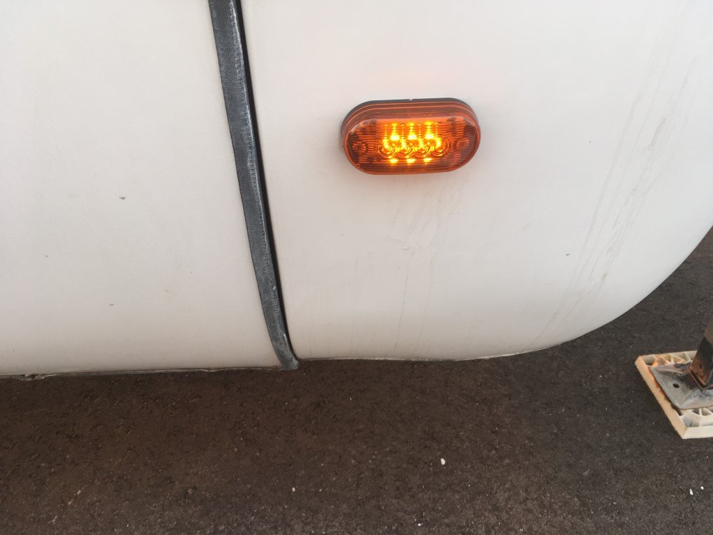

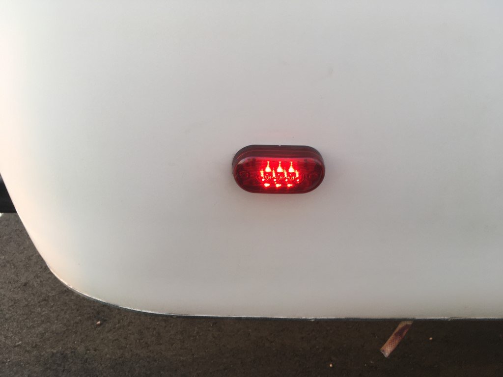

Scamp lighting leaves a lot to be desired and just replaced the original side marker lights you could hardly see with LED on my 19. Major improvement.
I purchased these and very happy with them:
https://amzn.to/3hIYyOl

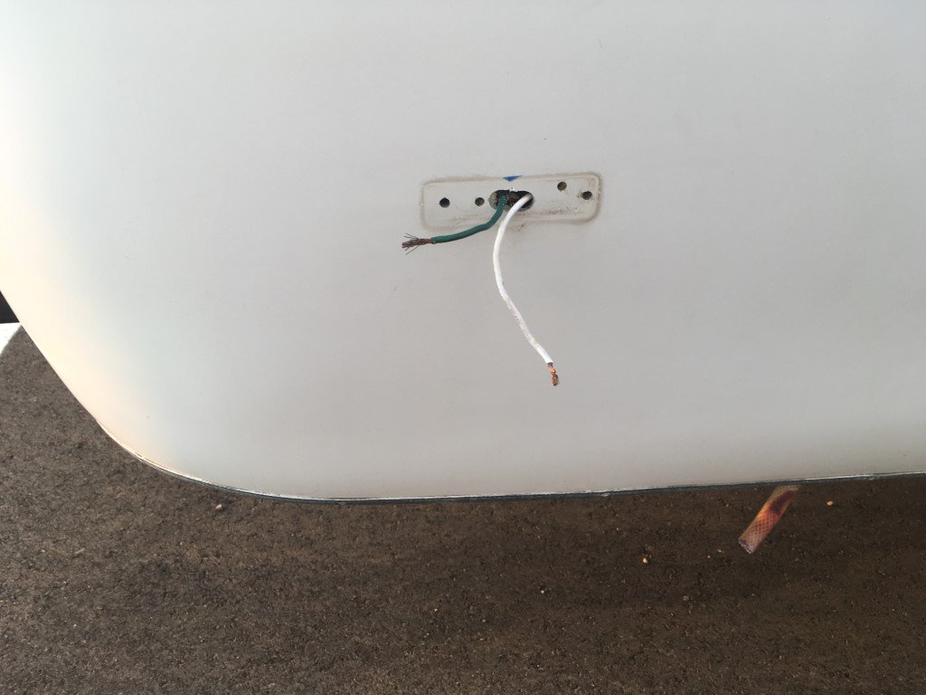

First I drilled a new center hole for the wiring as the small holes Scamp had for the wires didn't work with the new lights.

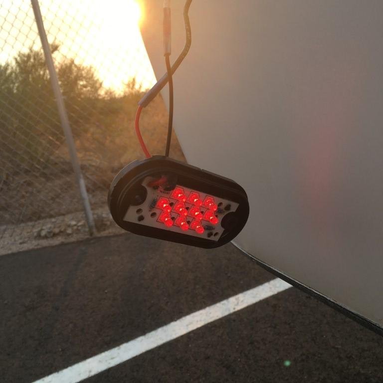

Next wired a test light after cleaning up and stripping the two wires. (Green is tail light wire to red on the new light. White is ground to black on the new light)
No issues or anything special outside of the new center hole and they are now very visible.
Not sure what Scamp is now using for running lights, but if you have the old one's this is a must do project. Cost approx $16, labor approx 2 hours.

Good point on LED marker and tail lights. Yes the LED's for those purposes do need to be the correct color to work properly. If you'll notice in my original post this is why I showed the rear marker lit without the lense so you can see the red LED's. The front markers have amber LED's.
Normally, if you buy quality marker and tail light assembly's and not just the bulbs you will usually find this is done correctly. If not, send them back.
