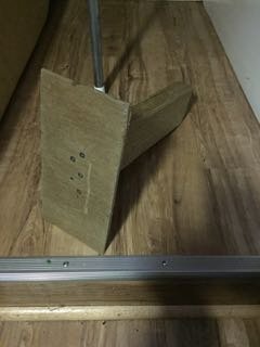

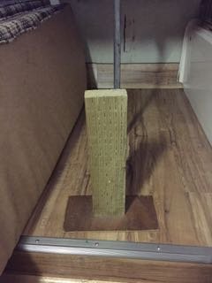

I like that! Do you have a picture of the dance floor support and did you cope the board to fit the bench ledges at all. I want to change mine this winter.

support leg
The support leg is a section of 2x4 screwed to a small 1/4" luan plywood foot, about 4x10" I looked out the door to go to the trailer to get a pic but its raining like stink. Ill get one for you later!

free standing leg pics
KVJ, here are the pics of the freestanding leg

Thanks
Doug, Thanks for going to the trouble to take a picture of the support. There are quite a number of us trying to figure a way to slide into the dinette a little easier. I've seen where some people have cut the table and installed piano hinge and supports to make it friendlier.
