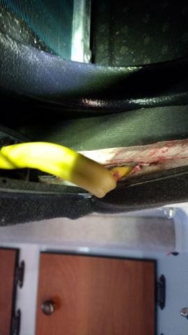

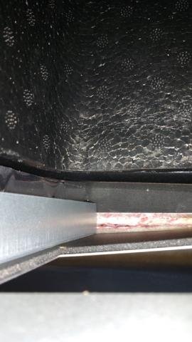

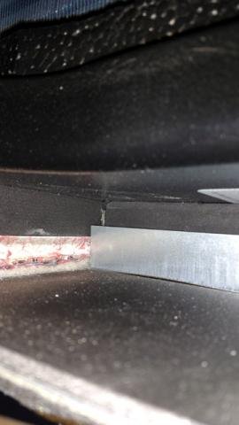

RE: It's a oak reinforced panel for the Scamp to,have the necessary support for a AC.
Are you sure about this?  I was repairing a leak caused by the screws that hold the air distribution box to the ceiling going all the way through the fiberglass roof, I did not see any wood.  This is what I found:
It might not be clear what you can see i the photos, but it is the A/C unit and seal on top, then the fiberglass, then the insulation and rat fur.  I see no wood.
And Kent Eveland told me this about the camper's A/C support::
What we do is support the roof with heavier fiberglass. All roof airs are basically made to go through a framed roof. Since no Scamp trailers have a framed roof, we build the glass up heavier with a core mat product.
In fact, I suggested that they add some glassed in wood to the ceiling for the air dist box screws and he said he would discuss it with his crew.

Heck, I was told oak, oh well
Heck, I was told oak, oh well, still reinforced for,an AC unit. We see the bulge in Scamps now since 2000.
