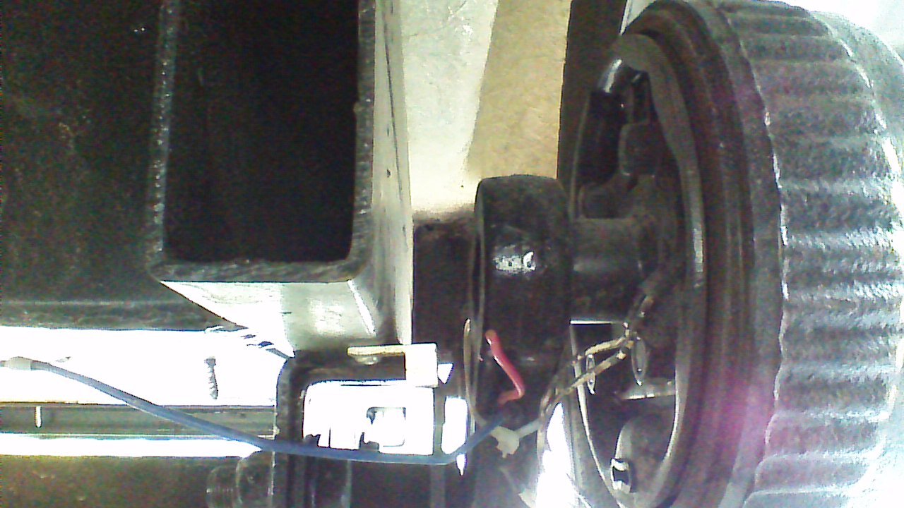

Sorry if this has been covered before but we just got back from Yellow Stone Park and our trailer brakes quit working half way through the trip. The problem is on some of the 2017 scamps the ground wire is to short and break off.  Its an easy fix just splice a long wire on.
Last seen: 6 days 11 hours ago
Employee
Apparently Scamp had a new employee on the line that cut the wires too short on the brake wires. They are covering the repair if one wants to take it into a shop, but Scamp would need to approve first.
As you indicated it is a fairly simple do it yourself fix.
