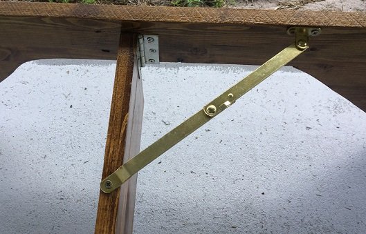

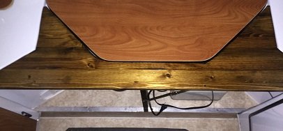

When travelling in the Scamp it doesn't take long to realize that if you're the one sleeping closest to the end of the bed, where the dinette table ends, the cushions sag down which I found was uncomfortable. I fabricated a small bed extension which sits on the channels of the front of the seats.
Just a piece of pine cut out to fill the gap where the cushions sag. To support the center I made this hinged leg. Just stained and poly'd it to protect the wood.
Made a four month journey much more enjoyable!

So this turns the corners and
So this turns the corners and goes all the way to the closet and all the way to the kitchenette! clever!!!
