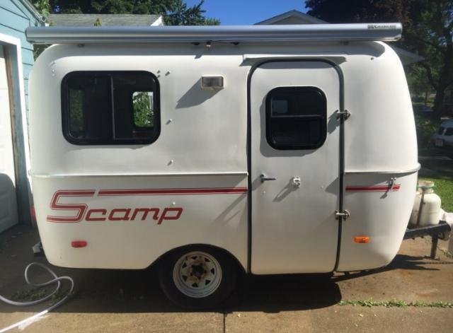

I know similar topics have been covered but I could not find one exactly the same so here goes....I recently bought a used 1994 Scamp and LOVE IT! I do have a quick question....Shortly after purchasing the Scamp I brought it home and worked to clean and fix it up. Everything worked great. But after I took it out for the first trip, the 12v lights stopped working. Even when plugged in. After looking over everything, I noticed the battery connection had broken off. I went to the store and got a new battery and connection to repair it. It now seems to work again. The question I have is why it stopped working when hooked up to power. It worked fine at my home & the battery it was hooked too was dead. REAL DEAD. Is it because the battery was not hooked up? Could it be because the circuit was not completed or do you think this is a bigger problem? I don't want the thing to catch fire.
