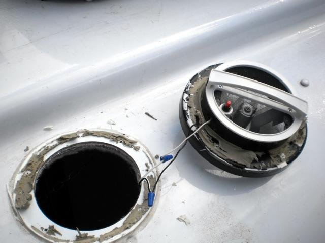

I am almost certain they will NOT put the bathroom window in because of too many leaks.
They use the VanAir powered roof vent now.
I had occasion to remove this vent on my 8 month old Scamp and re-install it in an effort to stop a leak that I thought was coming from the vent. The vent is held to the roof with about eight screws that penetrate the fiberglass roof.  There are also three screws that hold the interior trim ring in place, an they go up from the bottom and penetrate the roof.  All these screws are in an area sealed with butyl tape but if that fails, it wil leak.
IMHO the fan is not needed unless you regularly shower in the bathroom.  If you do not, its best to ask Scamp to NOT install the vent.  They might resist this because they would be worried about condensation causing damage that they would then need to cover under warranty.  But personally I would take that risk and reasonability for the decision to not have the vent.
