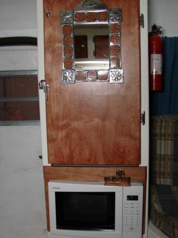

Well, Tom, not sure if it will help your dilemma since ours was an 81 13 Standard that I didn't mind cutting up. Modded it into the bottom of the closet and added a slide out drink table for lounging on the bed as well.
Here's mine...
The microwave I have is discontinued by now (it was about 18" wide and very difficult to install without cutting fiberglass). They are making smaller microwaves by now and that should make it easier to install. My top shelve carrying the toaster-oven over microwave acts as a bracket with felt padding and the bottom of the microwave is sitting on four rubber carpet pads glued down to help keep the microwave in place.
