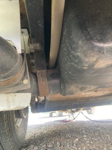

At some point while leaving a dispersed camping area, I lost the whole grey water tank discharge apparatus. In hindsight, I think I hit a rock while leaving the campsite (not the first time haha). I'm wondering if someone can help me out in determining what parts I need to order to replace this system. Thanks in advance for any help! Picture of the damage:

Not being the expert but looking at mine, I think you'll need a gate valve,a short section of pipe to connect it to the existing pipe, and a connector after the valve to which you'll attach your hoses. Assuming the existing pipe isn't a not damaged, I'd bet these are available at a local trailer shop or perhaps Amazon.

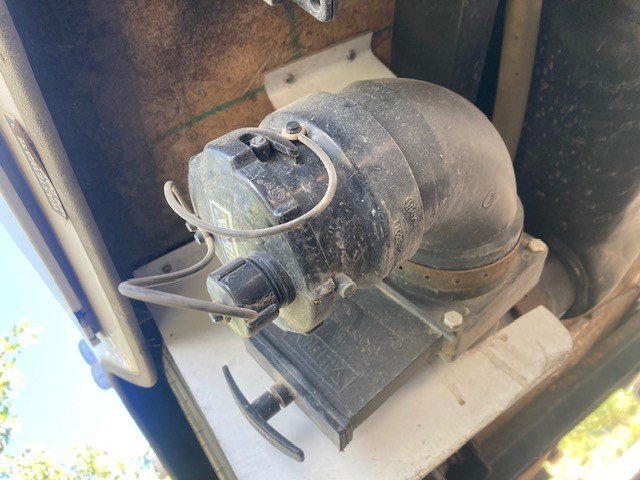

I wouldn't think this would be too difficult. I can send a picture of mine if that would help.
Edit: I looked at mine. You'll need 2 90° pipes and the sliding gate valve between them. Then you'll need the connector and cap to which the hose will attach.

Pics as requested
The first one shows where the pipe connects to the tank. Your's broke right at that strap, I think. Hopefully a new right angle piece can attach there. I changed to a cap that can also connect to a regular hose for my grey water. It was hard getting the angle right taking the picture under the trailer. The second right angle pipe and outlet are parallel to the floor.
